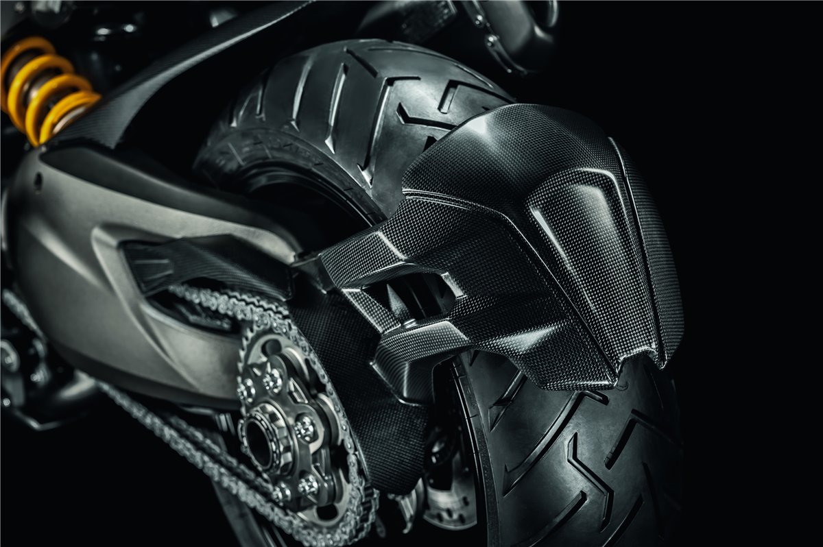

A: As long as there is 100mm between the mudguard and the wheel it will fit the back wheel
The Front tyre size needs to be between 90 – 125mm 16 to 18 inch.
The back tyre size needs to be between 140 and 200mm wide and 16 to 17 inch diameter.
Where a motorbike has an additional lower rear mud/splash guard, the mount system may not work. We had this issue with a Multistrada we owned, but we removed the rear guard so we could use the mount.
